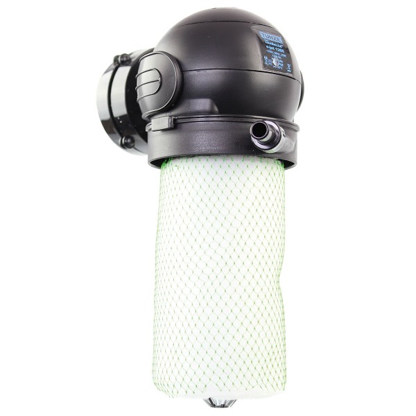

Hallo Micha, ich klemme das TB vom Aquarium ab und installiere meinen Powerfilter Tunze Turbelle e-Jet 3005 im TB. Der Mulm wird innerhalb ein paar Minuten schnell rausgefiltert.

tropicreef hat geschrieben:Hallo Micha, ich klemme das TB vom Aquarium ab und installiere meinen Powerfilter Tunze Turbelle e-Jet 3005 im TB. Der Mulm wird innerhalb ein paar Minuten schnell rausgefiltert.

Hi Mihai, in continuous operation is a powerfilter within the tank nothing else than a fleece filter unit with automatic filter roll like Theiling or Clarisea. Fleece filter is a high efficiency water filtration system which effectively removes suspended particles such as micro algae, detritus, food, organic waste and gravel dust from the water column. The advantages are
>> A fleece filter will completely replace the need for high maintenance filter socks and result in brilliantly clear water in the aquarium.
>> The use of a fleece filter will ensure the highest possible filtration efficiency for optimal light penetration and growth of corals.
>> Continuously removes detritus and organic waste from the water column preventing breakdown to nitrate & phosphate in the aquarium.
>> The fleece filter reduces the load on the protein skimmer by removing even the smallest of particles.
>> Constant filtration results in reduced maintenance of pumps, wave makers and protein skimmers.
>> A fleece filter will reduce the accumulation of detritus in the aquarium substrate and sump.
But it also reduces the nutrients in our tank.
see also SEAZ chapter "Rollvliesfilter („Vliesfilter“)"
