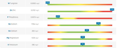

Please reduce the salinity to 35psu. Dose Iodine. Suspend Calcium dosing. I miss the values for Strontium, Bore and Flourine?

tropicreef hat geschrieben:Please reduce the salinity to 35psu. Dose Iodine. Suspend Calcium dosing. I miss the values for Strontium, Bore and Flourine?
tropicreef Strontium, Bore and Flourine are ok. You can find the full test in the pdf file attached . What about Molybdenum and Zinc? I think both come from Basic as they are considered nutrients /trace elements. I underdosed Sangokai Basis and they are still high, how should I proceed ? I have read Molybdenum is very toxic when in higher quantities , zinc is not that harmful.
What about the high levels of Cu and Al ? Should I do a massive water change?

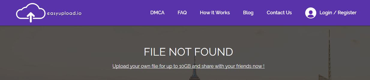

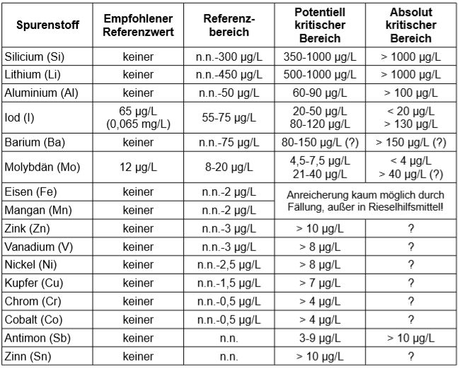

i can't open the pdf file. Error message: file not found. About zinc and molybdenum i wrote a lot here in the forum. like for molybdenum
look also on the tracemetall threshold table

thanks for the chart tropicreef

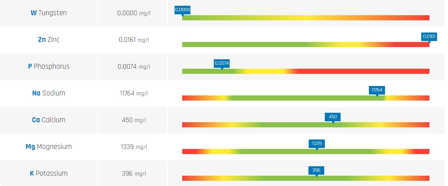

tropicreef hat geschrieben:I miss the values for Strontium, Bore and Flourine?
in the icp protocoll flourine is not listed. Also no chlorine. flourine can not be tested with an ICP-OES device. The main difficulty is to excite the fluorine atom because it is a halogen. All elements in this group are known to be more difficult to measure with ICP-OES, with fluorine being the most difficult of all.
from my prospective the first thing is to get the main components into a right balance. if they're not right, then I don't have to worry too much about trace metals. the salinity is too high. e.g the right value for pottasium at 37psu must be 431 mg/l. please reduce your salinity. how you measure the salinity?

I got the ICP results from the tank water at 30 March. I uploaded the results and also the results from the tank water present on 2 March.To sum it up the results are very close to each other. Between 2 and 30 March did two major water changes to try to fix the issues highlighted by the first ICP ( both around 75% of total real water volume ). I am new to reefing and ICP but for me it seems that only a few issues can possibly be at fault : the Tropic Marin Pro batch has the elevated levels or Al and Zn ; my rocks - especially the epoxy used leech Al and Zn or the ICP results are not accurate. Can’t imagine the food I add or the nutrients add those components (especially aluminum). What do you think might be the root cause ?
What can I do to reduce it apart from more water changes? The corals and animals don’t show any bad signs that I can recognise apart of the one acropora that does not show it’s polyps at all and looks all brown.
Some thread algae appeared in the tank for some time but I noticed it expanded a bit. Any feedback is welcomed.
