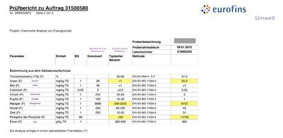

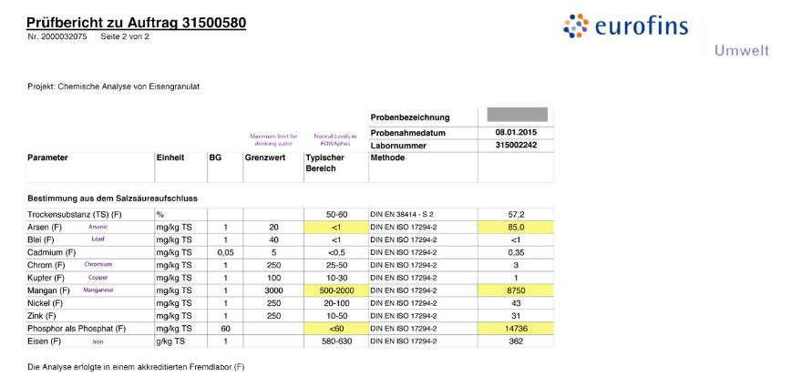

dies wurde heute auf Facebook gepostet; schon beachtilich wie Phosphatadsorber im Vorfeld belastet sind
Stuart Bertram hat geschrieben:VIRGIN OR NON-VIRGIN
when it comes to PHOSPHATE REMOVERS???
The majority of iron based phosphate removers available are actually designed to be used for the commercial removal of Arsenic from mains water. Phosphate is not a generally problem in drinking water and is actually added in some areas to reduce the toxicity of old lead pipework.
In a water treatment plant, the media is used in large filtration beds to remove Arsenic, Phosphate and Heavy Metals. It is of ultimate importance to ensure that Arsenic levels in drinking water do not breach the maximum safe concentration, and so the media is changed before fully exhausted, whilst it still has some remaining capacity.
This non-virgin waste material often finds its way into the aquarium industry as low cost phosphate media and is easily identified by analysis using spectroscopy, which immediately shows extremely high levels of Arsenic, Phosphate and Heavy Metals bound to the media.
Under normal pH conditions these toxins will remain bound and not release, however they are taking up the points for adsorption on the surface and so any further phosphate removal is significantly reduced and short lived.
Interestingly 2/3 of the commonly sold brands that we tested appeared to be of non-virgin origin. (See the independant analysis of a couple of the typical products tested)

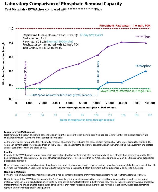

ROWAphos is the original Iron based phosphate remover used in the aquatic trade and is a virgin patented product guaranteed to remove more phosphate than any other product of its type on the market.
In our laboratory controlled tests on 12 different brands, Rowaphos removed 60% more phosphate than the best of those tested and almost 3 times more than 5 of the non virgin products.
In total 8 of the 12 products showed preloading which suggests that they are non virgin.
The impact on the phosphate removal capacity of the non virgin products is illustrated in the last image which tests the ability to remove phosphate in a single pass through the media, i.e. not recirculated.
